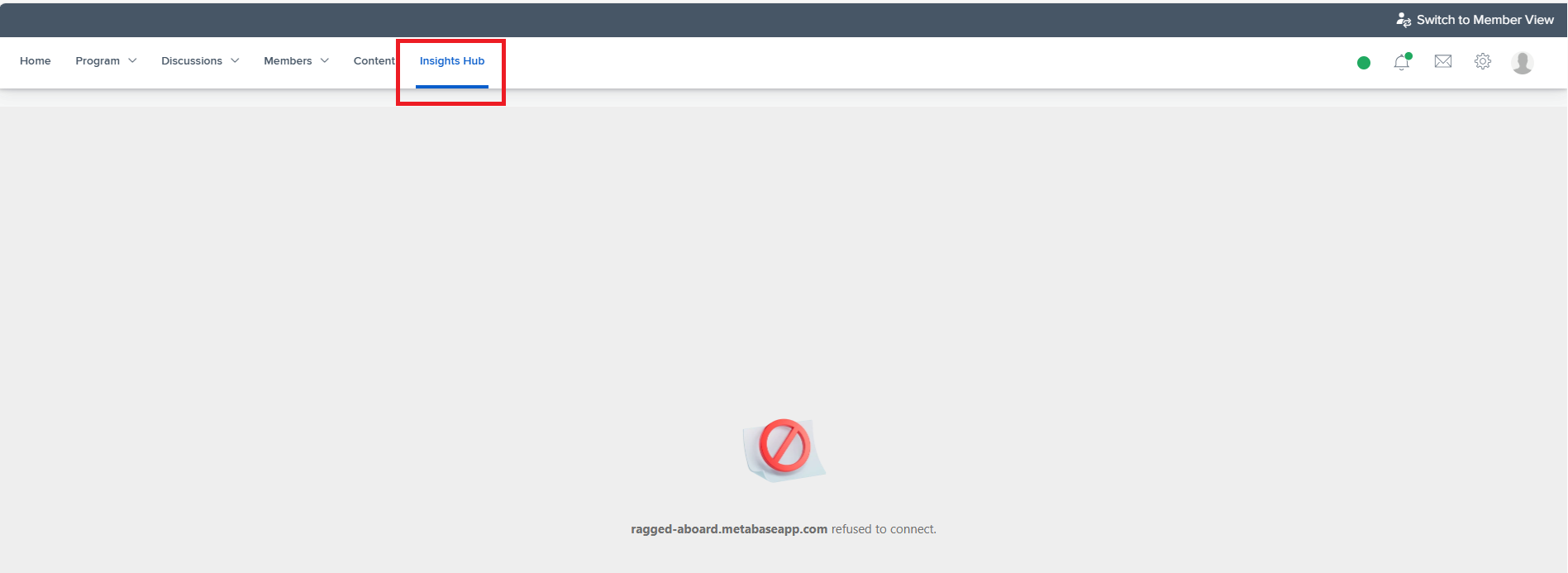

When a customer hub is hosted on a custom domain, the Metabase dashboards embedded in the Insights Hub tab may fail to load due to restrictive frame-ancestors or X-Frame-Options headers. These headers prevent the content from being embedded in iframes on unrecognized domains. This is not within the scope of SaaS support and must be routed to the appropriate Business Unit (BU) contact for allowlist changes.

    • Symptom:
      Error: ragged-aboard.metabaseapp.com refused to connect. Path: /corporate/metabase_dashboards when clicking Insights Hub.

    We have confirmed that for <Customer Name> on <custom-domain>, the Insights Hub /corporate/metabase_dashboards route shows “ragged-aboard.metabaseapp.com refused to connect.” The Metabase host responds with HTTP 200 but its frame-ancestors/X-Frame-Options headers do not include this hub’s custom domain, so the browser blocks the iframe. Direct access to https://insight.influitive.com with the customer’s Metabase account appears to work. Please add the customer’s hub domain(s) below to the Metabase embed allowlist so their Insights Hub tab can load dashboards correctly:
