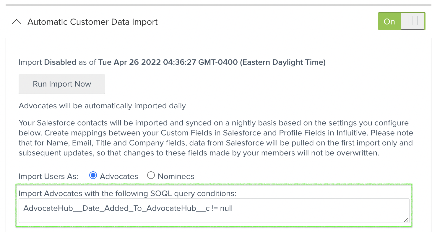

Changing the SOQL Query in your Salesforce Integration:
  1. You may need help from your Salesforce Administrator to create a new SOQL query. This SOQL query is created to identify the Salesforce users that you would like to be imported to the Hub (e.g. Salesforce contact records with certain Account Type or Products).
  2. Once you have this query, enter this in the Salesforce Integrations page (Admin view > Gear icon > Integration > Salesforce Card > Manage)
  3. Go to the Settings > Click the Automatic Customer Data Import tool > Paste the SOQL query in the box provided.
  4. Click Save.
