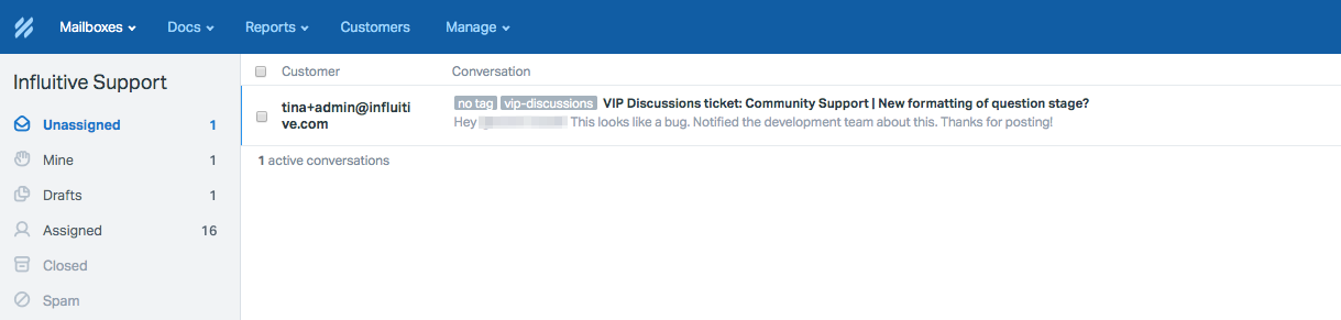

The Result
  1. Head over to the Discussions and pick a post to send over to the ticketing system
  2. Click on the three dots to expand the menu. You’ll see a lightning icon to click.
  3. Next, a window will pop-up for you to choose the ticketing platform to send this post to:
  4. Once you click Send, you should see a notification flag saying that it's been successfully sent. If there are any issues, please take a screenshot and submit a ticket to Influitive Support (support@influitive.com).
  5. You may need to wait a few minutes for the ticket to appear on your queue.
  6. If everything is working well, then you've completed the setup!
