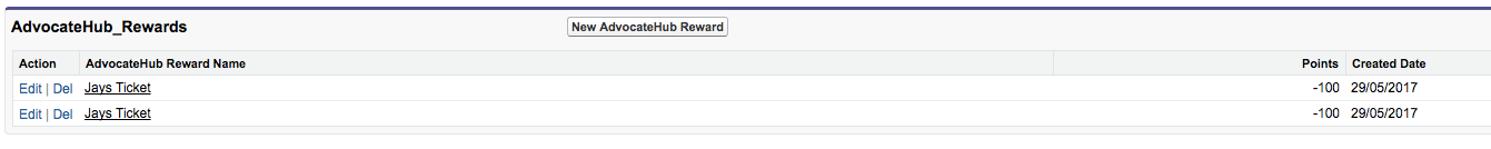

12. Turn your Zap on and test it out and you should see something like this on your Contact record in Salesforce
