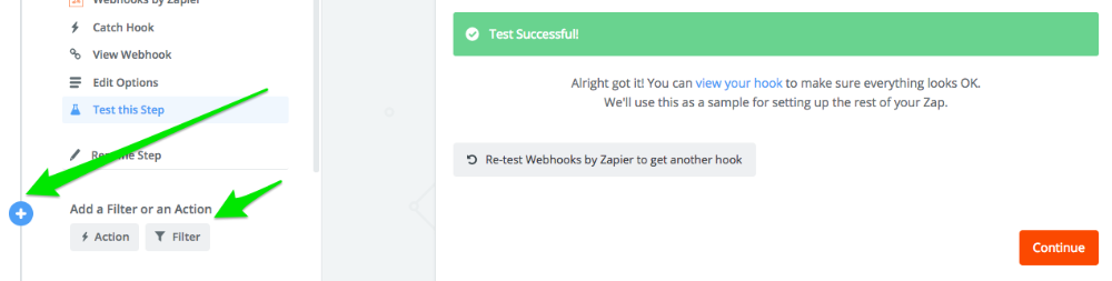

7. Now we are ready to test that the webhook is being caught so head back to Zapier and go to the 'Test this step' stage. Click 'OK, I did this' and quickly go back to your hub and redeem the T-Shirt reward in your AdvocateHub. If the webhook is working at this point you will see a screen like below:
8. Now we need to add a filter to our Zap in order to make sure this only runs on our specific reward. To add a filter you need to click the small '+' sign and then select  FIlter.
9. Go to the Edit Options. You will see 3 fields on the right-hand side. The first field is the data we want to select for our filter, in this case it is 'Source Name'. We want to have the text match  exactly the name of our T-Shirt reward in the AdvocateHub. So, it should look like below:
10. On the  Test this step section Zapier will give you an overview of when your Zap will succeed or fail.
