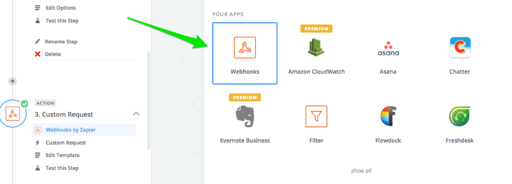

13. The final part requires us to complete the action on our webhook. We want to select Webhooks here.
