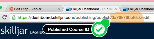

Get your Published Course ID by going to the Domains and Publishing section of Skilljar, and clicking the pencil under the Edit column on the course you're looking to award points for.
Next, copy the number/letter code in the URL of that page (the bit after publish/ and before /edit). That's your Published Course ID.
