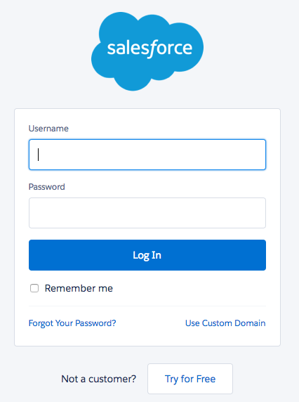

3.5 If you chose Salesforce, login with your Salesforce Username and Password.
Note: You may want to consult your Salesforce Admin on the login to use. Often they may want you to use a designated integrations user for this.
3.6 Click Allow to allow access

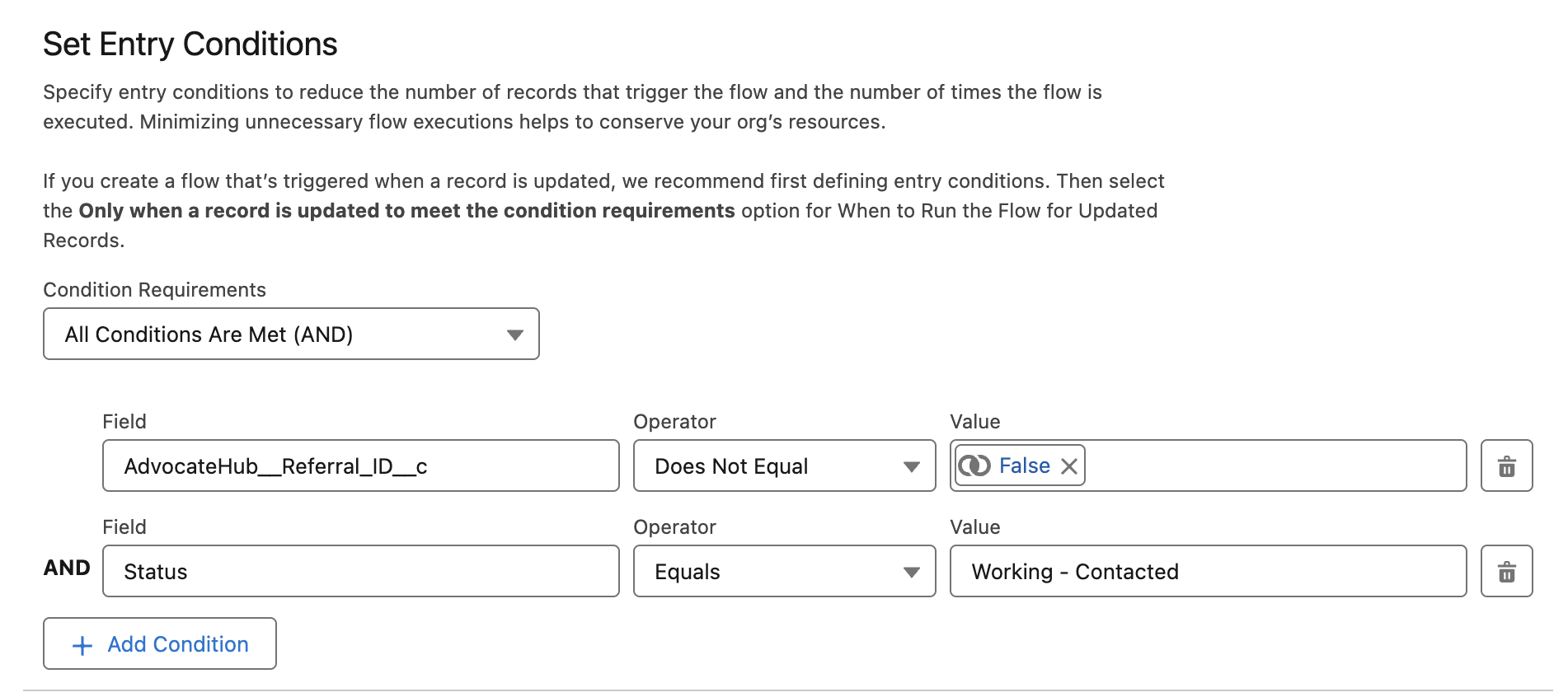

9.4 Configure Trigger > Trigger the Flow when: > Select “ A record is created or updated”
9.5 Set Entry Conditions. You can set your trigger criteria here. You should have a minimum of two criteria:
- Referral ID (appexchange) is not equal to blank (Required)
- Whatever the criteria are for triggering the milestone update (e.g. Field: "Lead: Lead Status" "equals" "Working - Contacted."
For this example, let’s use the following:
- Condition Requirements: All Conditions Are Met (AND)
- AdvocateHub__Referral_ID__c is not null (not empty). This means that it will only trigger if a Referral Lead is coming from Influitive and has the AdvocateHub Referral ID (appexchange) field populated.
- Lead Status is equals to the milestone status if your choosing.
9.6 When to Run the Flow for Updated Records: Every time a record is updated and meets the condition requirements
